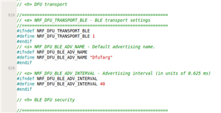

i would like to make 1 item go into pair mode and advertise OTA with a specific advertising name. I am trying to work with the ble_app_template example, but i cannot find how to change the advertising name from DfuTarg to what i want it to be.

  • Additional issue i had was the sdk_config file did not have correct settings. The tutorial didnt explain the need to update that. Once i updated NRF_SDH_BLE_VS_UUID_COUNT within the sdk, it did as expected. and increased memory. Your answer was helpful to establish memory for it. thanks
