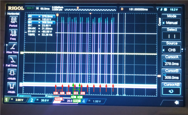

Now, I occasionally observe that the next timeslot, that is supposed to get triggered every 29000us (or longer in 100us steps) actually fires prematurely.
This is often accompanied by a hard-fault (not necessarily immediately)

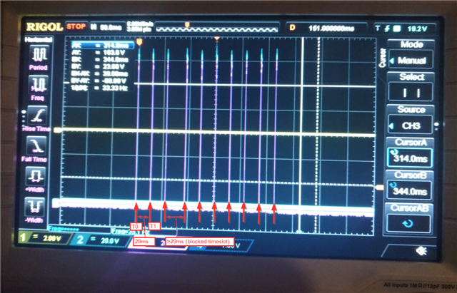

This long post can be summarized in the attached scope capture (using long persistence time) that depicts several 10 pulses bursts (normal capture and one with the phenomenon described)
The 'nominal' pulses that happen every 29ms are marked with red arrow and are evenly spaced
It can be also seen that there are premature pulses, marked with green arrow, that are triggered prematurely (but seem to retain the 29ms spacing)

Normal burst
