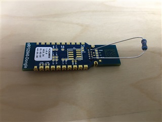

  • Also are the two date codes on the nRF52840 dies identical? Reducing the load on VDD can help with this .. there is a load cap on RESET  so if the RESET pin is disabled that may help .. or 100k resistor J2 pin 5 to pin 1 to bleed some current into Vdd..
    POWER: Device does not start up in high voltage mode This anomaly applies to IC Rev. Rev 1, build codes QIAA-Cx0, CKAA-Cx0.
  • Yes, that looks correct. maybe try with something like 2k or 10k .. this is my reasoning from the Errata document:
    Workaround Do not draw current from VDD pin (external circuitry supply) during power up and ensure VDDH rise time to 3 V is below 1 ms.
    Oh, and hopefully you are not using a coin cell or other high impedance power source? That would give a slow rise time .. USB stuff should be fine

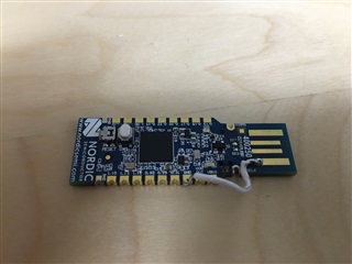

    1) FB2 has gone open-circuit, or got knocked off by the USB port plastic
    Excellent suggestion. That was it. The working dongle has the FB2:
    ..But the non-working one does not have the FB2 (maybe it is hard to see, but it is not there):
    It must of fallen off.

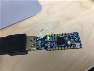

    per your suggestion, I shorted the USB GND and the GND edge connector. I couldn't quite bridge the FB2 just by soldering - little ugly, but this does the job:
    ...and now it is working!!! Thank you.
    From the 2nd page and 3rd page of the schematic, it seems that if FB2 is gone, there is no USB GND connection to the rest of the board (except for the test pads in the back). So it makes sense that the side edge GND pins were not grounded.

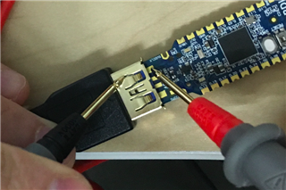

    BTW,
    So where are you measuring the Gnd voltage and USB Gnd?
    I measured the USB GND like below:
    and then the GND on the edge connectors.
