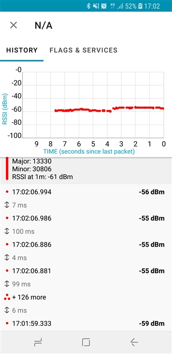

I am using an nRF52 DK to build a prototype for a product.
The device needs to have a connectable advertisement (as peripheral with multiples connections possible) and at the same time advertise a non-connectable iBeacon.
In order to do that, I am using SDK 15.2 and softdevice S132 for the connectable advertisement and the time slot API (based on experimental_ble_app_multiactivity_beacon example from SDK 11) for the iBeacon non connectable advertisement.
At the moment, the standard advertisement has an interval of 100ms. The time slot ibeacon advertisement has an interval of 400ms.
If I reduce the interval of the time slot advertisement (through timeslot_request.params.normal.distance_us) to 100ms (value 100 * 1000), I get a lot of radio errors (from NRF_EVT_RADIO_BLOCKED or NRF_EVT_RADIO_CANCELES).
Is there a way to handle those errors in order to be able to have this 100ms interval for the time slots ?
How should I handle the NRF radio errors ?
I have joined the c file containing my time slot code.

  • OK. I see the "TODO: A proper solution should try again" in the evt_handler. Is there a better way to handle those errors ?
    When I look at the iBeacon advertisement packets in nrf Connect, it seems that the advertisement interval is not very stable. Sometimes I have about 100ms between two messages, and sometimes, I end up with less than 5ms between two messages. Is there a way to get a stable interval and avoid these <5ms interval packets ?
    I'm not really sure why you have 5ms between two messages. Isn't it the interval you plan to have is 100ms ?
    One trick to show how the timeslot is being scheduled is to toggle a pin when you are inside a timeslot. Then using the logic analyzer to visualize it. It would be very useful if you can provide one.
  • Here is what nrfConnect shows me some messages with 100ms and some with <5ms. See below :
