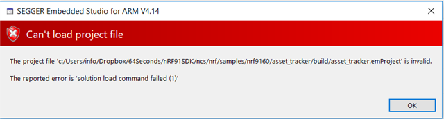

asset_tracker.emProject is reported invalid
I am running on a Windows 10 PC.
I've downloaded and installed all the tools for the nRF9160 DK using nRF Connect.
After installing the Segger Embedded Studio, I followed the instructions for "Open nRF Connect SDK Project" and I got a message stating ".../ncs/nrf/samples/nrf9160/asset_tracker/build/asset_trcker.emProject is invalid.  The reported error is 'solution load command failed (1)'

  • Hi Andreas,
    I gave those commands a try again but they didn't make any difference. What do those commands do?  Another question I have is in the "Getting Started Assistant", there is a requirement for a folder on the right called "sourceroot_code". This path was blank and empty the entire time I was doing the steps.  Should it have been filled in, and if so, what is the root directory?
  • Hi.
    Those two commands are pip commands, they run and install the content of requirements.txt

    And pip will install all of these.
    Could you try to save these two code snippets and run pip3 install -r <name_of_the_saved_file.txt> and see if that works?
     This should not affect the outcome of the installation.
    Also, which version of cmake do you have? (check with cmake --version)
