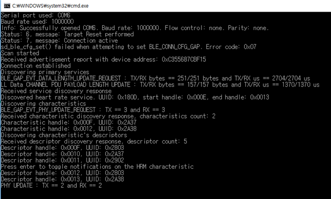

  4. Disconnection after connection establishing & receiving 5 heart rate samples

  2. Additionally, I want to ask what is the meaning of "un-handled event with ID : 18" and "disconnected reason : 0x22"
    and also, I want to know where can I check the "un-handled event with ID : 18" and "disconnected reason : 0x22"

    1) No, this is not the expected behavior.
    2)  Looking at the list here, we see that event 18 (0x12) is the same as BLE_GAP_EVT_CONN_PARAM_UPDATE. This is an event informing you that the connection parameters have been changed.
    Disconnect reason 0x22 is BLE_HCI_STATUS_CODE_LMP_RESPONSE_TIMEOUT.
    I see in the list that you also have another un-handled event with id=35, that is a BLE_GAP_EVT_DATA_LENGTH_UPDATE_REQUEST. This event needs to handled, or else you will disconnect, so this is the event that is causing the disconnect. This is something that the pc-ble-driver examples should have handled.
    Here is how you can handle the BLE_GAP_EVT_DATA_LENGTH_UPDATE_REQUEST event:
    Snippet:
    static void on_conn_data_length_update_request(const ble_gattc_evt_t * const p_ble_gattc_evt)
    	printf("BLE_GAP_EVT_DATA_LENGTH_UPDATE_REQUEST received\n");
    	ble_gap_data_length_params_t const dlp =
    		.max_rx_octets = 27,
    		.max_tx_octets = 27,
    		.max_rx_time_us = BLE_GAP_DATA_LENGTH_AUTO,
    		.max_tx_time_us = BLE_GAP_DATA_LENGTH_AUTO,
    	ble_gap_data_length_limitation_t dll = { 0 };
    	uint32_t err_code = sd_ble_gap_data_length_update(m_adapter, m_connection_handle, &dlp, &dll);
    	if (err_code != NRF_SUCCESS)
    		printf("sd_ble_gap_data_length_update failed, err_code %d\n", err_code);
     In ble_evt_dispatch() you will need this:
    		case BLE_GAP_EVT_DATA_LENGTH_UPDATE_REQUEST:
    			on_conn_data_length_update_request(&(p_ble_evt->evt.gattc_evt));

    3) You can find the documentation for the example here.
    Snippet:
    Complete main.c:

    My major problem and question are about 2) (increasing data length), and
    please see the following figures and my working history.
    Figures and Working History :
    First, in my the ble_app_hrs example, sdk_config.h defines NRF_SDH_BLE_GAP_DATA_LENGTH
    as following code so that ble_app_hrs example (BLE peri) sends heart_rate_collector_v6 example
    (BLE master) data_length_update_request of TX/RX bytes == 251/251 bytes.
    // <o> NRF_SDH_BLE_GAP_DATA_LENGTH   <27-251>
    // <i> Requested BLE GAP data length to be negotiated.
    #ifndef NRF_SDH_BLE_GAP_DATA_LENGTH
    #define NRF_SDH_BLE_GAP_DATA_LENGTH 251
    After that, heart_rate_collector_v6 example (BLE master) responds with following
    the function call, sd_ble_gap_data_length_update (m_adapter, m_connection_handle, &dlp, &dll)
    as shown in the attached code. But, it makes NRF_ERROR_RESOURCE.
    So, currently, I changed the function call to
    sd_ble_gap_data_length_update (m_adapter, m_connection_handle, NULL, NULL)
    according to the link (third case and picture), and the result is TX/RX bytes == 157/157 bytes.

    To resolve the NRF_ERROR_RESOURCE, and increase data length up to 251 bytes,
    I found some comments about data length update procedure in the
    ble_gap.h of the heart_rate_collector_v6 example (BLE master) as following text.
    @retval ::NRF_ERROR_RESOURCES
    The connection event length configured for this link is not sufficient for the requested parameters.
    Use @ref sd_ble_cfg_set with @ref BLE_CONN_CFG_GAP to increase the connection event length.
    Inspect p_dl_limitation to see where the limitation is.
    Accordingly, to increase connection event length, I changed ble_cfg_set() function
    in the heart_rate_collector (BLE master), but I got the error message that
    sd_ble_cfg_set() is failed due to invalid parameter, which is expressed the first figure.
    (my connection interval is 7.5ms in both BLE master and BLE peri)

    Questions :
    (1) How can I increase connection event length & LL data channel PDU payload length (data length)??
    (2) Where can I set the MTU of 247 bytes?? in both BLE master and BLE peri
