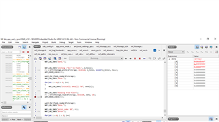

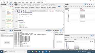

As you can see in the above image (watch) it is not getting copied.
When I am putting break points it is getting copied.

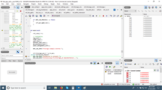

hitting first break point:

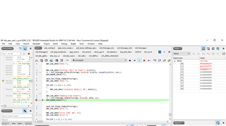

After reading the data:

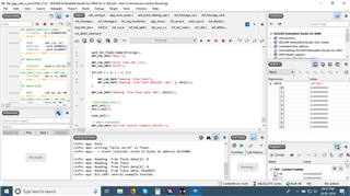

After running completely:
Why it is not executing completely? I am including my main too.

    The last part of your log is missing, so it is not possible to see from where what is happening. It is not entirely clear to me, but it seems like that is the only problem, since reads seems working when you check with a debugger? In that case it might be that you log too fast compared to the processing of the logs, and/or use a too small log buffer. I suggest you either stop using deferred logging or increase the log buffer so that you make sure you actually get everything printed. I do not see any need for a delay.

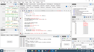

    This is my final LOG with debugging.
    This is my final LOG with out debugging.
    I am having a bit of problem getting an overview of this. To get better understanding:
    • Can you upload the log as test rather than screenshots?
    • Can you upload the exact code you used to produce the log? (it is difficult to know if it matches when there are several days between when the log and code was posted).
    • Can you elaborate what the problems are now?
    The typical reasons for failing to read back the correct data from flash are:
    • Flash page not erased. This example does not erase the flash page before it is written to. Can you make sure to do a full chip erase before running this code? If not, you may have "leftovers" 0's from earlier flash content, as writing can only flip 1's to 0's.
    • Not waiting for the flash write operation to complete. This does not seem like the problem here, though.
