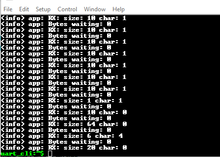

  • I'm not sure why you only receive one byte. Here are the changes I made in SDK 15.3.0 example:
    diff --git a/examples/peripheral/usbd_cdc_acm/main.c b/examples/peripheral/usbd_cdc_acm/main.c
    index 51e6a3f..a87c3cd 100644
    --- a/examples/peripheral/usbd_cdc_acm/main.c
    +++ b/examples/peripheral/usbd_cdc_acm/main.c
    @@ -129,7 +129,7 @@ APP_USBD_CDC_ACM_GLOBAL_DEF(m_app_cdc_acm,
                                 APP_USBD_CDC_COMM_PROTOCOL_AT_V250
    -#define READ_SIZE 1
    +#define READ_SIZE 256
     static char m_rx_buffer[READ_SIZE];
     static char m_tx_buffer[NRF_DRV_USBD_EPSIZE];
    @@ -150,9 +150,9 @@ static void cdc_acm_user_ev_handler(app_usbd_class_inst_t const * p_inst,
                 bsp_board_led_on(LED_CDC_ACM_OPEN);
                 /*Setup first transfer*/
    -            ret_code_t ret = app_usbd_cdc_acm_read(&m_app_cdc_acm,
    -                                                   m_rx_buffer,
    -                                                   READ_SIZE);
    +            ret_code_t ret = app_usbd_cdc_acm_read_any(&m_app_cdc_acm,
    +                                                       m_rx_buffer,
    +                                                       READ_SIZE);
                 UNUSED_VARIABLE(ret);
    @@ -173,9 +173,9 @@ static void cdc_acm_user_ev_handler(app_usbd_class_inst_t const * p_inst,
                     NRF_LOG_INFO("RX: size: %lu char: %c", size, m_rx_buffer[0]);
                     /* Fetch data until internal buffer is empty */
    -                ret = app_usbd_cdc_acm_read(&m_app_cdc_acm,
    -                                            m_rx_buffer,
    -                                            READ_SIZE);
    +                ret = app_usbd_cdc_acm_read_any(&m_app_cdc_acm,
    +                                                m_rx_buffer,
    +                                                READ_SIZE);
                 } while (ret == NRF_SUCCESS);
                 bsp_board_led_invert(LED_CDC_ACM_RX);
    And here is the log output I got (notice that it receives up to 64 bytes in this case - baudrate set to 115200):
    Can you try the same?
