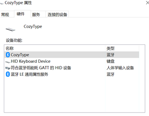

The output report used for capslock LEDs is abnormal when I combine HID keyboard and mouse to one device(nrf52840, s140).
Hi guys, help me please.....
I want to build a device act like both keyboards and mouse. I've made some progress that the device can connect to my PC(win10) successfully and I can send keys to my PC, but there are two problems:
1, The output report is abnormal, when I get the report type in the callback function(on_hid_rep_char_write), I get 1(BLE_HIDS_REP_TYPE_INPUT)and it should be 2(BLE_HIDS_REP_TYPE_OUTPUT)。
2,I send a right-click action to PC but nothing happens.
My codes:

    But, I lost the mouse functionality......
  • Did you try adding the USB descriptor that is included in the ble_app_hids_mouse instead of the one you're using? In the main.c file I added, parts of the mouse (the buttons + wheel) seems to coexist fine with the keyboard descriptor. Its then just a matter of adding the X/Y descriptor.
    Håkon
  • Hi Håkon,I tried and it works!Now I can send the keyboard data and the mouse data to my PC, it's perfect, Thank you!
    Best regards,
    Martin
  • Glad to hear that it works! Have a nice weekend Slight smile
    Håkon
