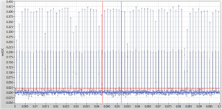

Periodic current spikes while sleeping when twis is enabled
I need the nrf52 as a I2C slave, so I set up a very minimal example:
void i2c_event_handler(nrfx_twis_evt_t const *p_event)
    switch (p_event->type) {
    case NRFX_TWIS_EVT_READ_REQ:
        nrfx_twis_tx_prepare( ... );
    case NRFX_TWIS_EVT_READ_DONE:
    case NRFX_TWIS_EVT_READ_ERROR:
    case NRFX_TWIS_EVT_WRITE_REQ:
        nrfx_twis_rx_prepare( ... );
    case NRFX_TWIS_EVT_WRITE_DONE:
    case NRFX_TWIS_EVT_WRITE_ERROR:
    case NRFX_TWIS_EVT_GENERAL_ERROR:
static void i2c_init(void)
    nrfx_twis_config_t config = {
        .addr = { 3, 0 },
        .scl  = PIN_I2C_SCL,
        .scl_pull = (nrf_gpio_pin_pull_t)NRFX_TWIS_DEFAULT_CONFIG_SCL_PULL,
        .sda = PIN_I2C_SDA,
        .sda_pull = (nrf_gpio_pin_pull_t)NRFX_TWIS_DEFAULT_CONFIG_SDA_PULL,
        .interrupt_priority = NRFX_TWIS_DEFAULT_CONFIG_IRQ_PRIORITY,
    nrfx_twis_init(&i2c_dev, &config, i2c_event_handler);
    nrfx_twis_enable(&i2c_dev);
void clock_event_handler(nrfx_clock_evt_type_t event) {}
static void clock_init(void)
    nrfx_err_t err_code;
    err_code = nrfx_clock_init(clock_event_handler);
    nrfx_clock_enable();
    //nrfx_clock_lfclk_start();
    ret_code_t err_code;
    if (NRF_LOG_PROCESS() == false) {
        nrf_pwr_mgmt_run();
    clock_init();
    power_management_init();
    i2c_init();
    for (;;) {
        idle_state_handle();
which seems to work so far. the chip wakes up, receives the i2c msg and is able to send back data.
but if I look at the current consumption, I see a periodic peek (700Hz) and I have no idea by what it may be caused:

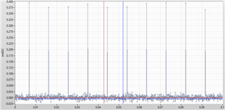

if I don't initialize the i2c, it looks like this:
any idea?
