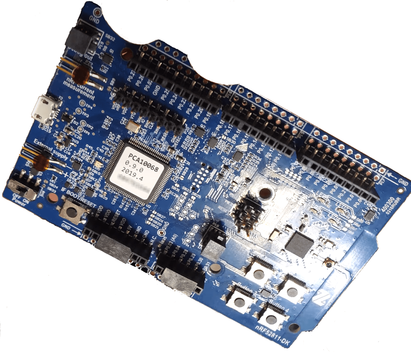

Any update on the progress of the nRF52811 dev board?
Hey Nordic,
Any idea on when the nRF52811-DK board (PCA10068) will be made available to the wider development community?
It won't, but you can use the nRF52833DK instead. You'll have to reduce the flash and ram sizes for the target device, and there's a fewer peripheral instances here and there, but other than that it should be as if you're on a nRF52811. Effectively doing the reverse of this chapter Transferring the project to nRF52811 hardware, but use the nRF52833 instead of the nRF52840 as the target.
