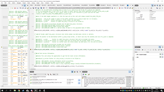

I am attempting to incorporate NUS example (app_uart) into the HID keyboard example. The whole thing compiles with no warning, but when I add {BLE_UUID_NUS_SERVICE, NUS_SERVICE_UUID_TYPE} to m_adv_uuids, the adverstising never starts. I was able to locate where it fails through the debugger. When it enters the line APP_ERROR_CHECK(err_code) it fails.

  • well you could just debug through to find out where the error is returned or look at the error code to see which one it is. Most likely you've put too much in the advertising packet and overfilled it so you're getting an error that there's no space.
  • Sorry, I see now what you mean. I have found out here what is the advertising packet. I know how to reduce the size taken by my device name, but it's not enough. I would need to reduce the data field of the NUS, but I'm not sure where to edit that. Probably in ble_nus.h. I will continue to look.
  • OK, so you get NRF_ERROR_INVALID_PARAM returned from ble_advertising_init()? Which SDK are you using?
    Assuming SDK 15.2, this means that the error probably comes from ble_advdata_encode(). That function is responsible for encoding the advertisement packet and is quite easy to understand. Essentially there is an if statement for each field, so you can check with a debugger which fails (which is invalid).
  • Hello Einar, yes, that seems to be the function that returns the error. More specifically, it's the If Statement that encodes the complete UUID list.
    This statement calls the function uuid_list_encode() so I went further to see what could be the problem. This function is in two parts, one for encoding 16 bits UUIDs and the other for encoding 128 bits UUIDs.
    When encoding my first service, HID, the debugger will enter this function, execute the 16 bits and 128 bits sections with no failure. However, when encoding the NUS service, it enters the same function but fails at the 16 bits encoding and skips over the 128 bits encoding, resulting in the error code 0x07.
    Is there a way to specify which encoding to use for NUS without impacting the encoding for HID?
  • Ok, so I went further with the debugger. Inside uuid_list_encode(), there is two calls for the function uuid_list_sized_encode(). In that function, there is a call to another function, sd_ble_uuid_encode() that I'm pretty positive is the source of my problem. Looking in that last function, you see that it returns NRF_ERROR_INVALID_PARAM when the UUID type is invalid.
    You can see that the type for NUS is 0x02 (BLE_UUID_TYPE_VENDOR_BEGIN). Somehow it doesn't seem to recognize 0x02 as a valid type. I changed it to 0x01 (BLE_UUID_TYPE_BLE) with the debugger and the error was gone, but of course, I know 0x02 should work, normally.
    Now I need help resolving why it doesn't accept 0x02 as a valid type...
  • I see. Then I assume the problem is that the SoftDevice has not been configured with the custom base UUID. This is done by ble_nus_init(), so this has to be called before you configure the advertisement packet. You can see the same issue with the NUS example from the SDK if you change the order of the calls to services_init() and advertising_init().
  • Thank you so much for your help. I initiated the NUS service before advertising it, as you said. I had another problem that followed where I did'nt have enough RAM. I was able to change it and now I have successfully implemented NUS with HID. Again, thank you.
