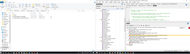

HI Einar,
I got the SDK file thingysdkv210.zip
from https://www.nordicsemi.com/Software-and-Tools/Development-Kits/Nordic-Thingy-52/Download#infotabs
I also attach the content of the file
nRF_52_Thingy_v2.1.0\project\pca20020_s132\ses
got errors like:
nordic_common.h: No such file or directory
F:\1.nRF_52_v1\nRF_52_Thingy_v2.1.0\source\modules\thingee_ble_handler.c: No such file or directory
F:\1.nRF_52_v1\nRF_52_Thingy_v2.1.0\source\modules\thingee_config_flash.c: No such file or directory
ble_types.h: No such file or directory
and
I want to work with nRF_Thingy to read the sensors data for R&D.
nrf_tthingy firmware is open source or not?
The thingy firmware is available in source. You can find it on Nordic's website like you did, or on github. As mentioned it did not officially have any SES project, so adapting the project to SES is a bit of work. The SES project included in the last zip archive is broken and was not intended to be used. See this thread.
