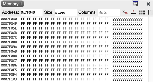

Hi all,
I have an issue when trying to use the fstorage without the SoftDevice. The documentation explains that it is possible to use the FStorage without SoftDevice if the NVMC api backend is used, that is what I do. I have no issue when reading data from flash but when I try to write something, there is absolutely no data written to flash. I used the example provided in the SDK15.

    return_code = nrf_fstorage_write( &fstorage, 0x7F040, pu8TestTab, sizeof(pu8TestTab), NULL );
    APP_ERROR_CHECK(return_code);
    /* Wait during flash writing operations */
    vWaitForFlashReady( &fstorage );
The event handler function is called as expected and gives the following message :
 app: --> Event received: wrote 4 bytes at address 0x7F040.
I used the debugger to visualize the flash content, unfortunately no data written to the flash :
Thanks a lot for your help !
