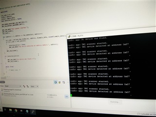

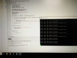

    Thank you for the quick response. When I have connected the sdk(nrf52840) to MAX30100 sensor using TWI scanner example running in sdk it can read the device address and it is showing the address as 0x57. But, when i have connected to another sdk(nrf52840) it is showing as "no device was found" please find the attached images.  nrf52840 connected to MAX30100Device address detected

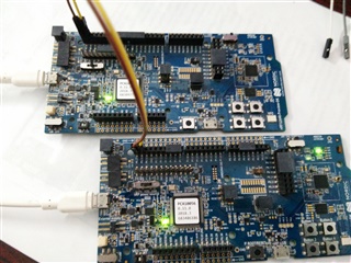

    two nrf52840 dk connectedNo device found for two sdk boards connected

  • when i have connected to another sdk(nrf52840) it is showing as "no device was found"
    So, again, have you programmed an I2C slave into that other DK?
    If you have both the MAX30100 and the 2nd DK connected, is the MAX30100 still detected?
    Have you looked at the I2C lines with an oscilloscope or analyser to see what is happening?
    How exactly can i get the address ?
    Again, when you're making an I2C Slave on any microcontroller, then you assign its address in your code!

  • Thank you, I have not programmed I2C slave in other DK. I just tried to run TWI scanner on one board to get the address of other board but, it did not work that way. As you suggested I will run I2C slave in one board and try again.
    How do i assign I2C slave to any controller (address in code) can you give a code snippet ?
  • I have not programmed I2C slave in other DK
    You need to!
    Just like you have to write code to use the TWI peripheral code in Master mode!
    Without code to control it, the TWI peripheral does nothing.
    That will depend on the particular microcontroller - it will be different in an nRF52 from an STM32.
    You will have to study the documentation for the particular microcontroller to find out what is required.
