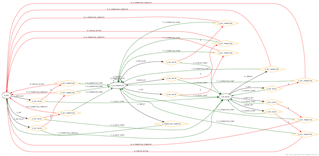

    I suggest that you try to set #define FSM_DEBUG (1) in nrf_mesh_config_core.h on line 519. It will then post some finite state machine debug information in the log.
    It seems a bit complicated. It looks like it depends on what state it was in before calling fsm_event_post(). My best tip for you is to try it out with the FSM_DEBUG = 1 and see what happens.

    One of my colleagues sent me this photo, which they used when they wrote the code:
