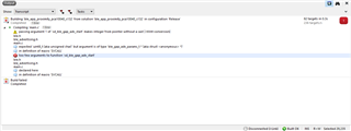

    I am a bit lost here. The warnings and error messages does not seem to match the code. It complains that you make a integer form a pointer for m_adv_handle, but I do not see that in your code. Moreover, there is an error for too few arguments for sd_ble_gap_adv_start(), but that is also not the case. Do you get these errors with the same code as in your previous post from today?
    Please make sure you are testing with the correct code, and if it still does not work, can you upload your complete project (including project files etc.) to this case so that I can try to build it on my side?

    I am a bit short on time this week, so unfortunately I am not able to implement the central and peripheral examples modifications for you at this point. However, I would like to teach you how to proceed with this, by first doing basic debugging. When I received your code I got some compiler errors, which are straight forward to fix. You will save much time by fixing those yourself like you would do with any other C program.
    Starting with the first warning and error, which is caused by the same problem:
      Compiling ‘main.c’
        passing argument 1 of 'sd_ble_gap_adv_start' makes integer from pointer without a cast [-Wint-conversion]
        ble.h
        ble_advertising.h
        main.c
        expected 'uint8_t {aka unsigned char}' but argument is of type 'ble_gap_adv_params_t * {aka struct <anonymous> *}'
        in definition of macro 'SVCALL'
        too few arguments to function 'sd_ble_gap_adv_start'
        ble.h
        ble_advertising.h
        main.c
        declared here
    The offending line is this:
    err_code = sd_ble_gap_adv_start(&adv_params);
    As you can see, the error message clearly states that you have too few parameters in the call to sd_ble_gap_adv_start(). Looking at the API documentation you can see that  you pass one argument, but it should be two. Moreover, as indicated by the warning message you pass a pointer as the first argument, which is incorrect as it should be an uint8_t. Then it follows that you have to fix this as described by the error message, so it matches with the prototype of the sd_ble_gap_adv_start() function, as described in the API documentation:
    err_code = sd_ble_gap_adv_start(m_adv_handle, APP_BLE_CONN_CFG_TAG);
    Now we have fixed the obvious issue that prevented your code from compiling. However, it still does not make much sense, and will not achieve what you want. For some reason you are configuring the advertising parameters inside the peer_manager_init() function, and then also starting advertising subsequently on line 470 in advertising_start(), which then leads to an expected NRF_ERROR_INVALID_STATE error.
    The post you linked to does not use the advertising module, but handles advertising packets itself. What do you want to do? If you want to do like in the other thread, that should be no problem, but  you only need to take care of the API differences so that you don't get the errors we have discussed earlier. Please compare API documentations and respect compiler warnings and errors. Then this should be no problem.
