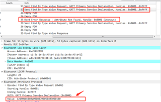

BLE_GATT_STATUS_ATTERR_ATTRIBUTE_NOT_FOUND
I used NRF connect to connect to a slave。
I want to use the central to connect to the device。

but the service is not found。

and    p_ble_gattc_evt->gatt_status ==0X010A.
i use sniffer to get the packs.
In my understanding, this can find the service, where am I wrong?
thank you  very much.
