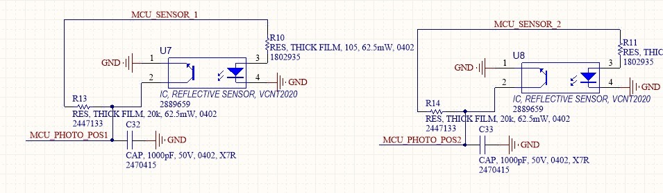

I'm planning to connect The nRF52840 MCU GPIO in series to a 1.8V 20mA LED and a Resistor then to ground.
Would the current from the MCU be sufficient to power the LED ?

How do you configure a GPIO to current sink?
I tried the following but it doesn't seem to work.
nrf_gpio_cfg(LED_1,NRF_GPIO_PIN_DIR_OUTPUT,
NRF_GPIO_PIN_INPUT_DISCONNECT,
NRF_GPIO_PIN_NOPULL,
NRF_GPIO_PIN_H0H1,
NRF_GPIO_PIN_NOSENSE);
nrf_gpio_pin_write(LED_1,0);
Thank you
Chong
It's not about the GPIO configuration - it's how you connect the LED.

I am connecting the LED like Figure 1: +V is 3.3V and PORT Pin is configured as LED_1 and led_pin. I have 2 LEDs configured as the same connection.
Both GPIO codes don't work.
Thank you
Chong
Which pins are you using for led_pin and LED_1? P1.x pins do not have high drive capability (NRF_GPIO_PIN_H0D1), nor do some P0.x pins; this is sometimes overlooked .. Also be aware that if 3.3V is very much higher than your nRF52840 i/o voltage there may be issues with back-drive (phantom power) into the port pin.

I'm using P0.11 P0.12 P1.06 P1.07
All P1.x have no high drive capability?
Thank you
It was just a quick look, but I couldn't see that mentioned in the Product Specification ?
As with debugging any problem, you need to take this one step at a time.
For a start, have you tried using an unmodified SDK example on a DevKit? That is always the best place to start - giving you a known-good basis to work from.
