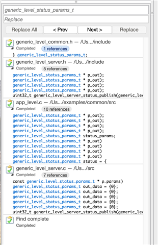

I was going through generic_level_messages.h and generic_level_common.h files looking for the parameters for generic level status message.
I noticed that generic_level_messages.h has "remaining_time" parameter set as a 8-bit parameter whereas generic_level_common.h has "remaining_time_ms" parameter set as a 32-bit parameter.
In Segger IDE, I notice that the "generic_level_status_params_t" from generic_level_common.h is getting referenced a lot in the project(in generic_level_server.c/.h; app_level.c) as shown below and "generic_level_status_msg_pkt_t" from generic_level_messages.h is being referenced only once.
Why is that parameter(remaining_time_ms) defined as a 32-bit value instead of a 8-bit value when the specifications say it has to be a 8-bit value(which is satisfied in the message packet format)?? Why does the SDK have two different length for same parameter though one is in milliseconds and the other is not?
