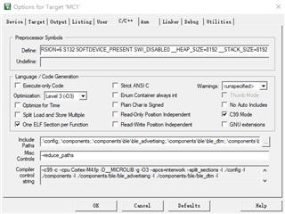

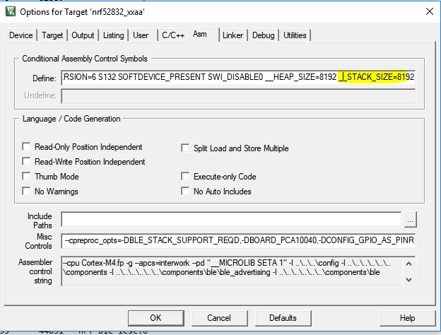

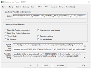

nrf52832 .map file display arm_startup_nrf52.o use ZI-data 32KB (actually is RAM), that used nearly half of my RAM!
  • SDK: 15.0
  • SoftDevices: s132
  • IDE-Version:  μVision V5.26.2.0
  • Toolchain: MDK-ARM Plus Version: 5.26.2.0
  • OS:windows10
  • chip:nrf52832 (64KB/512KB)
Question:
first of all:

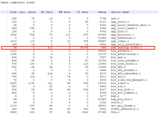

ROM space : Code+RO Data+RW Data
RAM space : RW Data + ZI Data
this is my project .map file description:
Obviously, my ram of chip is not enough.so,I found this in .map :
my  arm_startup_nrf52.o file use ZI data = 32768 ,that used nearly half of my RAM! (chip total RAM is 64KB, here 32KB )
this is my project arm_startup_nrf52.s code file

  • Can anyone tell me how to reduce the RAM usage of the arm_startup_nrf52.o file?
  • Please check what the size of "STACK" is in your map file. You can change the size of the allocated call stack by changing the pre-processor definition as shown below.
  • as you wish,I am pretty sure that the size of the heap and stack is very low in the engineering configuration, absolutely no 32KByte.In addition, my project is a project that adds audio decoding. In the audio decoding module, a large amount of RAM may be used.

     You have __HEAP_SIZE  set to 0x6000 which means that 24KB of the RAM will be allocated to HEAP. But this section gets removed by the linker if you don't actually use HEAP. So it sounds like you are using heap memory in your audio module?
