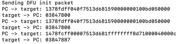

    I have been trying to analyze the messages sent back and forth between the PC and the target while establishing the initial UART communication.
    Case1:
    Sending DFU start packet, afterwards we wait for the flash on target to be initialized before continuing.
    PC -> target: 0502aabbccdd
    target -> PC: 0582aabbccdd
    Got echo response
    Sending DFU init packet
    PC -> target: 1378fdff040fd3260a7859000000010003000000
    target -> PC: 03847800
    PC -> target: 1478fcff0000d3260a78ffffffff5d71000040000c
    target -> PC: 03847887
    I assume that the PC -> target message contains 59-company id, 1 - app-id, 3- application version that I sent. Is that right?
    The response from the target to PC is 03847800. What does this indicate?
    The third response back from the target to PC is 03847887. This is different from the first two responses. When the PC gets this response back, the DFU stops(fails). What does this value indicate?
    Is there any link that I can refer to regarding these messages?

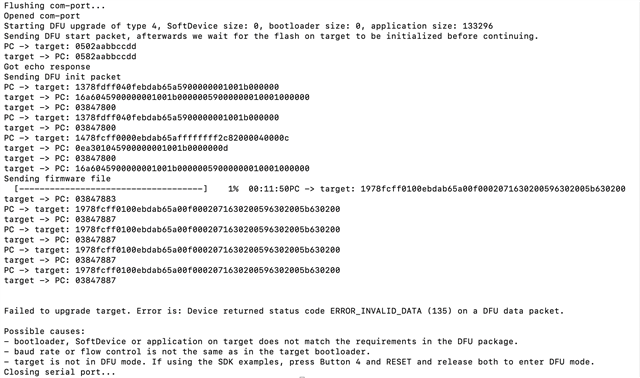

    Please check out the Serial commands, Serial events and Serial status codes in the mesh sdk documentation.
    So, basically, 03847887 means:
    03: Internal Events Report
    84: Cmd Response
    78: DFU Data
    87: ERROR_INVALID_DATA
    So it means that the init packet is not accepted.

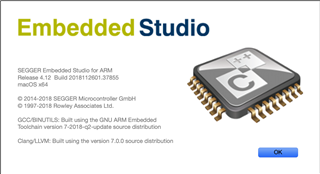

    We have seen some weird behavior on certain compiler versions. So what IDE/compiler do you use? Segger Embedded Version? What version?
  • We have seen some weird behavior on certain compiler versions. So what IDE/compiler do you use? Segger Embedded Version? What version?

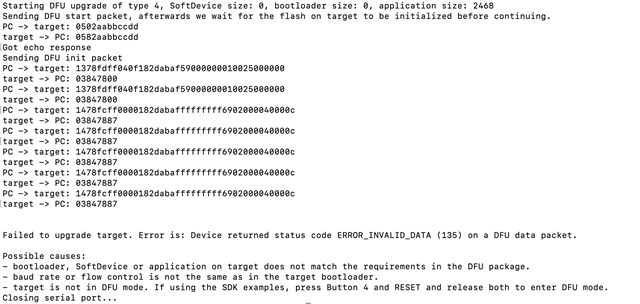

    Since you suggested previously, I have been using only SES v3.40. But I keep getting this response frequently.
    Additionally, I have noticed that once the DFU transfer stops in the middle(for example, my PC went to sleep after transferring 87% which stopped sending packets); there is no way to resume the DFU from that point. I tried pushing the new update with increased version number. It failed sending the error code for ERROR_INVALID_DATA.
    How does the flash for new FW image get freed? Does it gets overridden overtime new DFU is pushed or does the flash gets erased after the node loads the new FW?
    The error that I mentioned, is there any chance that it could be because of the DFU packets stored during the previous transfer.
     That is because the device is probably expecting the next packet in the sequence. It should be possible to resume by sending the next packet, but this is not something that nrfutil currently supports. You would have to do this by altering the nrfutil FW, or wait until the DFU times out, and start over.

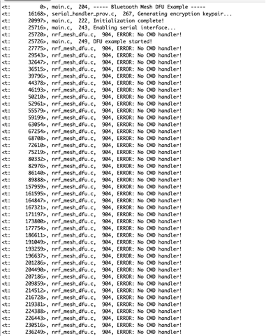

    How many DFU pushes can the board handle?
    Is there any time frame needed between each push?
    I am having hard time pushing the DFU multiple times.I have been pushing the same FW image of DFU example as well as customized example with DFU over and over again but the second DFU push fails most of the time. Sometimes, second push is successful but third fails. It fails sending the error code for ERROR_INVALID_DATA.
    I did try it by sending commands individually and also using scripts(version number is increased everytime). If there was something wrong with either commands or the scripts, it would have failed in the first push but it fails on second or third push. Also,  I am not even changing the hex files for pushing. It is the same file that was used for the first push.
    In the customized example, I do change the name and push it so that I see the indication that the device is successfully updated with new FW image.
    I dunno why but I feel that the flash which stores the new FW image isn't accepting the new image as I can see that the initial messages that are sent to check the ID's reply back with Success code which is 0x00.
    The DFU start message which carries the start address, size of the application is the one that is returning back with the ERROR_INVALID_DATA reply
    The only difference that I see with the DFU start message when the DFU is pushed successfully and when it fails is the transfer ID field in the message packet. I don't see anything else changing. So, I am still unsure on what is going wrong while trying to push the same FW again and again.
    It would be great if you or any of your colleagues find time to push DFU example multiple times onto the same board and see if there is anything wrong with that?
     1 at the time.
     Yes.
    You need to check out the defines that i mentioned in the previous reply. TIMER_DATA_TIMEOUT_US and TIMER_START_TIMEOUT_US. It will not accept a new image until any of these times out. Please let me know if you can't find them.
    As mentioned. I am out of office, so I don't have any HW to test this on. Please open a new ticket so that one of the guys in the office can check.
     One of these two is happening:
    1: The application that is stored is already up to date. You need to increase the application version to make the device accept it.
    2: The device is still expecting the next packet from a previous session because TIMER_DATA_TIMEOUT_US has not timed out and TIMER_START_TIMEOUT_US has not timed out.
    Edvin
