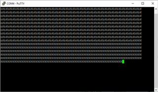

Hi, I'm having problem with UART communication. I use basic UARTE code and I want to send simple data to PuTTy terminal. The problem is whatever I would send i get only 'K' in my terminal and no data at all. I attach my code and screenshot from PuTTy. Terminal configuration seems to be fine. I get "Kb" if I try to send more than 1 byte. Thanks for your help in advance Slight smile
PS. I'm using SiliconLabs CP210x chip for uart-usb conversion.

// Configure the UARTE with no flow control, one parity bit and 115200 baud rate
NRF_UARTE0->CONFIG = (UART_CONFIG_HWFC_Disabled << UART_CONFIG_HWFC_Pos) |
(UART_CONFIG_PARITY_Excluded << UART_CONFIG_PARITY_Pos);
NRF_UARTE0->BAUDRATE = UARTE_BAUDRATE_BAUDRATE_Baud9600 << UARTE_BAUDRATE_BAUDRATE_Pos;
