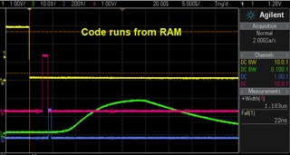

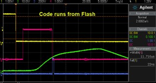

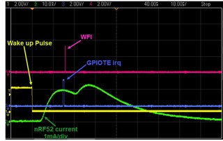

what is the typical or max wake up time of the nRF52 from the RTC or GPIOTE irq (when configured as sense for low level input)?
In my setup, I see a wakeup time of ~13usec from the moment that the nRF52 current consumption is increasing, till the time the RTC irq handler is running.
RTC is running from an external crystal.
Normally I would expect the following wakeup delays till the start of RTC irq handler:
tSTART_HFINT Startup time: 3us
tIDLE2CPU Time from IDLE to CPU execute: 3us
What is the reason that I see 13us and not 6us till the RTC handler starts to execute code?
The wakup time from an external GPIO sense low event that I measure is ~16us.
