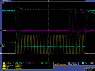

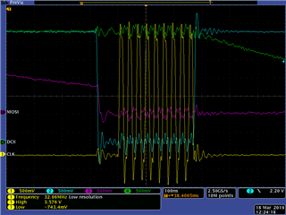

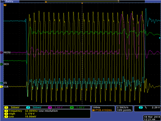

**Everything behaves as expected until step 8(i) where I am experiencing several issues:
  • The SPIM3 module is sending out 18 clock cycles (sometimes more or less) instead of 8 even though I set TXD.MAXCNT = 1
  • The MOSI line is sending out all “0” (MOSI is set up to send 0xAA), and sometimes “0” plus garbage data, and sometimes “0” plus the actual data I intended to send but offset
  • The D/CX line is set to “1” even though I set up DCXCNT = 1
In the above image, this is an example of what I see for step 8(i).  10 clock cycles are sent, followed by 8 additional clocks with MOSI actually being correct but offset by 1 clock.  D/CX is not set low as I intended.

    After the long EasyDMA write, I see an 8-bit transaction, followed by a 24-bit transaction, where D/CX is not set to "0" as I intended.  It's interesting that I intended to transmit 0xAA command but neither of the below transactions are 0xAA.

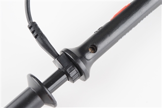

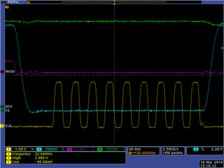

  • Could you adjust the 'scope probes and repost the photos? Example tips for adjustment of probes here. Additionally each 'scope probe requires its ground clip to be connected to a nearby ground on your board.
  • Here are the recaptures of the photos.  I also offset the CLK and MOSI to help the transitions be clearer.
