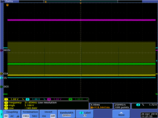

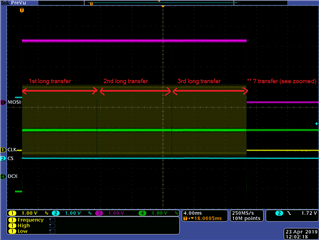

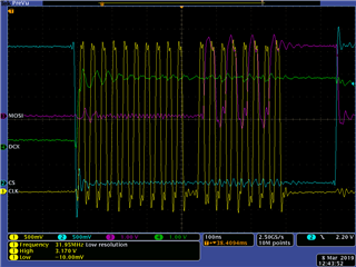

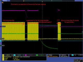

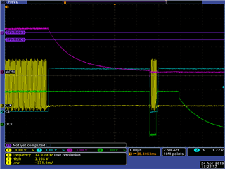

**Everything behaves as expected until step 8(i) where I am experiencing several issues:
  • The SPIM3 module is sending out 18 clock cycles (sometimes more or less) instead of 8 even though I set TXD.MAXCNT = 1
  • The MOSI line is sending out all “0” (MOSI is set up to send 0xAA), and sometimes “0” plus garbage data, and sometimes “0” plus the actual data I intended to send but offset
  • The D/CX line is set to “1” even though I set up DCXCNT = 1
In the above image, this is an example of what I see for step 8(i).  10 clock cycles are sent, followed by 8 additional clocks with MOSI actually being correct but offset by 1 clock.  D/CX is not set low as I intended.

  • In 8a above SPIM3 Stopped, 8b SPIM3 Disabled. Uh-oh, maybe a step is missing, vis 8a1 SPIM3 Stopped Event:
    The SPI master can be stopped in the middle of a transaction by triggering the STOP task. When triggering the STOP task the SPIM will complete the transmission/reception of the current byte before stopping. A STOPPED event is generated when the SPI master has stopped
    The STOP task may not be always needed (the peripheral might already be stopped), but if it is sent, software shall wait until the STOPPED event was received as a response before disabling the peripheral through the ENABLE register
    Perhaps a suggestion - The 'scope traces above are nice, but would be infinitely better if the probes were adjusted to match the 'scope impedance, usually a tiny screw adjustment on the probe used when connected to the reference Square wave on the 'scope for just that purpose. That would make the waveforms much clearer.
    I have the PPI set up to automatically trigger the SPIM3 stop command when the Timer2 reaches the Compare0 value of 4. This is in step 3.c.b.  Shouldn't the SPIM3 have already issued TASKS_STOP by step 8A? Thanks
  • Agreed; and I suppose at 32MHz that doesn't take long to happen. However if the STOPPED event confirmation was never generated the code now has no error recovery. Is it possible to see the actual code? Maybe we could replicate the problem.
  • Sure, also as a note, I did try adding TASKS_STOP = 1 for the SPIM3 module at the beginning of the interrupt but didn't have any luck with that.
