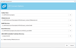

I have been setting up nRF9160 DK following nRF Connect SDK.
OS: Windows 10, 32 bit
I have trouble when I load asset_tracker.

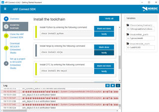

I guess ninja would be related to this error. I installed ninja, but cannot verify it on the SDK.
Any help?
Here is the output log in SEGGER Embedded Studio.
Loading solution asset_tracker.emProject
Executing load commands
cmake -GNinja -DBOARD=nrf9160_pca10090 -DBOARD_DIR=C:/nRF9160/ncs/zephyr/boards/arm/nrf9160_pca10090 -DZEPHYR_TOOLCHAIN_VARIANT=gnuarmemb -DGNUARMEMB_TOOLCHAIN_PATH=c:/gnuarmemb -BC:/nRF9160/ncs/nrf/samples/nrf9160/asset_tracker/build -HC:/nRF9160/ncs/nrf/samples/nrf9160/asset_tracker

-- Cache files will be written to: C:\Users\NEC-PCuser\AppData\Local/.cache/zephyr
CMake Error at C:/nRF9160/ncs/zephyr/CMakeLists.txt:11 (project):
Running
'C:/ProgramData/chocolatey/bin/ninja.exe' '--version'
failed with:
a??a?3a??a?≪a??a??a?|a??a?aa??a??a??: System.ComponentModel.Win32Exception:
a??aR?a??a??a??aR?e!?a? ̄e??a??a?!a??a?≪a? ̄a??a?R OS
a??a?ca??a??a??a?ca??a??a?≪a ̄?a??a?|a??a?1a?aa?¢a??a?aa?±a??a?・a?§a?3a?§a? ̄a??a??a??a??a??a€?
See also "C:/nRF9160/ncs/nrf/samples/nrf9160/asset_tracker/build/CMakeFiles/CMakeOutput.log".

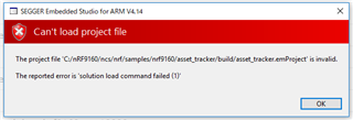

Project load failed
Reported error: solution load command failed (1)
