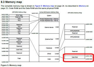

    why would the value of data_array be such a large number?
    Again, this is standard 'C' programming - nothing specifically to do with Nordic or even embedded microcontrollers!
    In 'C', the name of an array - such as "data_array" -  gives a pointer to the first element of the array; or, in other words, the address of the first element of the array.
    So, if you print that, you will very likely get a large number!
    showing a value of 536884548
    So that's 0x20003544 - which is, indeed, an address in the nRF52 RAM:
