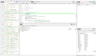

I need to get nrf9160 to connect to a LTE-M network. We are using a custom pcb module with nrf91 on it. I've managed to get a simple hello world, blinky and gps simulator example up and running but I am having trouble with LTE. As soon as I include BSD_LIBRARY (which is automatically included with LTE_LINK_CONTROL, and presumably a dependency) my example refuses to run. While debugging, the processor is stopped by a vector catch soon after startup, and it was unable to hit a breakpoint at the start of the main function. I assume the problem lies in the interaction of BSD_LIBRARY and our pcb, but fail to understand how it could happen. My project is currently setup with the default DK board as the board directory. I am yet to attempt to create a custom pcb directory as I lack the necessary information on how to configure it.
I am attaching a screenshot of the debug screen.
If you have any idea on how to further approach this problem I would be most grateful.
