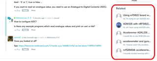

How to configure ADC?
Is there any example programs which read analogue values and print on uart or ble?
Have you looked at all?
See: https://devzone.nordicsemi.com/f/nordic-q-a/44588/nrf52-as-twi-slave/174992#174992
Note also the 'Related' topics which the Forum helpfully finds for you:
