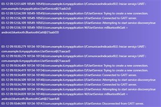

I'm developing an application on Android based on nRF_UART apk source, but i'm having trouble in connecting to two BLE devices. Actually, i think i could manage to connect to two devices, but the problem stands on Tx Characteristic notification, it looks like i'm receiving the same message from both devices, which is not supposed to happen, each device should send a different message.
Is there any help or guide through connecting to more than one BLE device at the same time?

My guess is something related to the GATT layer wich does not allow more than one instance of the characteristics
Here is a screen shot of my log cat while trying to connect to 2 BLE devices
Android Log Cat
If someone could help me i'd be very glad!
