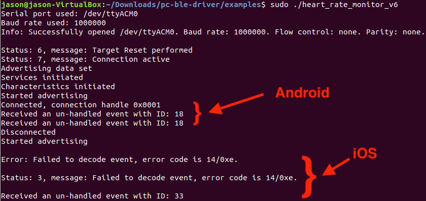

pc-ble-driver not working on iOS and with some Android phones
We are having an issue with pc-ble-driver (https://github.com/NordicSemiconductor/pc-ble-driver). We're using the nRF52840 dongle. We have compiled and run the `heart_rate_monitor_v6` example. We have flashed the dongle with `connectivity_1.0.0_usb_with_s140_6.1.0.hex`. We are not able to bond with iOS devices and some Android devices when we run the default heart rate monitor example.
console
There's the working output for Android. Which loads our GATT profile and everything appears to be working fine in the nRF Connect App. However, iOS and some Android phones do not load anything in nRF Connect. Not sure exactly what the issue is. We suspect it could be related to devices using private non-resolvable mac addresses. Any help would be appreciated!
    I will set up a test here to try replicating the issue on my side. Sorry for the delay. Just some follow up questions to make sure I can reproduce it: should I test with the master or release (4.0.0) branch, and do I need to make any changes to the sample code?
  • We cloned master. You do not need to make any changes to the sample code. We are seeing the issue on the default heart_rate_monitor_v6 example.
    Thanks
  • Thanks. I used the "release/4.0-compiled-connectivity" branch since I couldn't get the current master to work (chrashed with segfault before advertising start), but I think the issue between master and release is the same, the reference code does not handle required BLE events such as data length update (MSC). Not all phones have support for data length extension which explains why some phones work with this example while others do not. Please try the modified example below and see if it works for you.

            case BLE_GAP_EVT_CONNECTED:
                m_connection_handle = p_ble_evt->evt.gap_evt.conn_handle;
                printf("Connected, connection handle 0x%04X\n", m_connection_handle);
                fflush(stdout);
                printf("Disconnected\n");
                fflush(stdout);
                m_connection_handle = BLE_CONN_HANDLE_INVALID;
                m_send_notifications = false;
                advertising_start();

            case BLE_GAP_EVT_DATA_LENGTH_UPDATE_REQUEST:
                ble_gap_data_length_params_t const dlp =
                    .max_rx_octets  = 27,
                    .max_tx_octets  = 27,
                    .max_rx_time_us = BLE_GAP_DATA_LENGTH_AUTO,
                    .max_tx_time_us = BLE_GAP_DATA_LENGTH_AUTO,
                ble_gap_data_length_limitation_t dll = {0};
                err_code = sd_ble_gap_data_length_update(m_adapter, m_connection_handle, &dlp, &dll);
                if (err_code != NRF_SUCCESS)
                    printf("sd_ble_gap_sec_params_reply() failed. Error code: 0x%02X\n", err_code);
                    fflush(stdout);
            } break;
            case BLE_GAP_EVT_DATA_LENGTH_UPDATE:
                printf("Data length updated. %d", p_ble_evt->evt.gap_evt.params.data_length_update.effective_params.max_tx_octets);

            default:
                printf("Received an un-handled event with ID: %d\n", p_ble_evt->header.evt_id);
                fflush(stdout);
