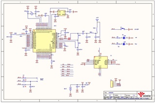

Using the above mentioned example on a custom board with nf51822. i want to transmit both eddystone uid and tlm frames at the same time is this possible?

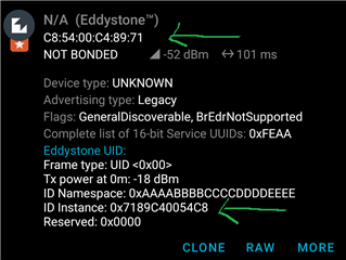

    This is where i used the function call but there was no change in the advertising data.
    sd_ble_gap_address_get()
    it looks like you are writing one byte of your pointer value to  APP_EDDYSTONE_UID_NAMESPACE.
    Try to replace this code:
    ble_gap_addr_t *p_mac1;
    sd_ble_gap_address_get(p_mac1);
    eddystone_uid_data[3] = (uint8_t) p_mac1;
    With this:
    ble_gap_addr_t addr;
    err_code = sd_ble_gap_address_get(&addr);
    /*Offset of APP_EDDYSTONE_UID_ID = APP_EDDYSTONE_UID_FRAME_TYPE+APP_EDDYSTONE_RSSI+APP_EDDYSTONE_UID_NAMESPACE*/
    memcpy(&eddystone_uid_data[12], addr.addr, sizeof(addr.addr));
    Edit: you should use SDK 12.3.0. The eddistone example was in an experimental state in SDK 11.
