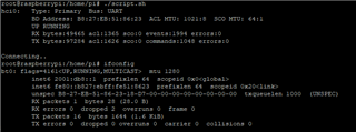

Here my script used for the connection (00:07:3E:C4:C6:8C MAC address of my nrf52840) :
#modprobe bluetooth_6lowpan
echo 1 > /sys/kernel/debug/bluetooth/6lowpan_enable
hciconfig
hciconfig hci0 reset
echo "Connecting.."
sleep 1
echo "connect 00:7E:3E:C4:C6:8C 1" > /sys/kernel/debug/bluetooth/6lowpan_control
echo 1 >  /proc/sys/net/ipv6/conf/all/forwarding
sleep 1
sleep 1
ifconfig bt0 add 2001:db8::1/64
service radvd restart
Here my radvd.conf :
interface bt0
        AdvSendAdvert on;
        prefix 2001:db8::/64
                AdvOnLink off;
                AdvAutonomous on;
                AdvRouterAddr on;
Here the connection and test of bt0 :

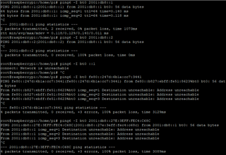

I can ping 2001:db8::1 but this is all, I can't ping localhost / eth0 nor my card

          source link-address option (1), length 8 (1): b8:27:eb:51:86:23
            0x0000:  b827 eb51 8623
11:02:56.089460 IP6 (hlim 255, next-header ICMPv6 (58) payload length: 32) fe80::b827:ebff:fe51:8623 > ff02::1:ffc7:3441: [icmp6 sum ok] ICMP6, neighbor solicitation, length 32, who has fe80::247d:6b1a:cc7:3441
11:02:57.109921 IP6 (hlim 255, next-header ICMPv6 (58) payload length: 32) fe80::b827:ebff:fe51:8623 > ff02::1:ffc7:3441: [icmp6 sum ok] ICMP6, neighbor solicitation, length 32, who has fe80::247d:6b1a:cc7:3441
11:02:57.109980 IP6 (hlim 255, next-header ICMPv6 (58) payload length: 32) fe80::b827:ebff:fe51:8623 > ff02::1:ffc4:c68c: [icmp6 sum ok] ICMP6, neighbor solicitation, length 32, who has fe80::7e:3eff:fec4:c68c
11:02:58.149919 IP6 (hlim 255, next-header ICMPv6 (58) payload length: 32) fe80::b827:ebff:fe51:8623 > ff02::1:ffc4:c68c: [icmp6 sum ok] ICMP6, neighbor solicitation, length 32, who has fe80::7e:3eff:fec4:c68c
11:02:58.149978 IP6 (hlim 255, next-header ICMPv6 (58) payload length: 32) fe80::b827:ebff:fe51:8623 > ff02::1:ffc7:3441: [icmp6 sum ok] ICMP6, neighbor solicitation, length 32, who has fe80::247d:6b1a:cc7:3441
11:03:04.896893 IP6 (flowlabel 0xd855d, hlim 255, next-header ICMPv6 (58) payload length: 56) fe80::b827:ebff:fe51:8623 > ip6-allnodes: [icmp6 sum ok] ICMP6, router advertisement, length 56
        hop limit 64, Flags [none], pref medium, router lifetime 1800s, reachable time 0s, retrans time 0s
          prefix info option (3), length 32 (4): 2001:db8::/64, Flags [auto, router], valid time 86400s, pref. time 14400s
            0x0000:  4060 0001 5180 0000 3840 0000 0000 2001
            0x0010:  0db8 0000 0000 0000 0000 0000 0000
Here what I get from /var/log/syslog after bt0 go down:
I don't really know where the problems can come from, from what I've seen from the topic on forums, older os for the raspberry are recommended (like raspbian wheezy), since the project has a few years, but I can't put them on the raspberrypi 3b+.
So I've started asking myself if the problem doesn't come from the fact I use a raspberrypi 3b+ since i haven't see any post on the forums where someone use this model. Do you know if the problem can come from here ?
Thank you !
