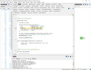

In this code I'm face a problem. The issue is when i debug, it shows "<info> app: TWI device detected at address 0x6D". Please find attached a snapshot of the issue.

Hi Everyone,
Need your help ASAP. Thanks
