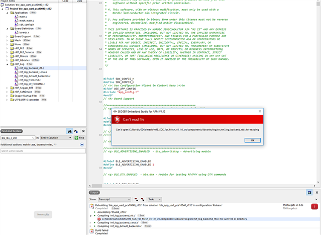

i am using latest sdk 3.1 mesh ,nRF52832 development kit while i am building it showing   error "boards.h no such directory found ", even tools are set .how to solve this issue

    If you receive another compiler error later due to a missing .c file in Segger Embedded Studio, you can find the path of this file by clicking on the file location here.
    Example below:
