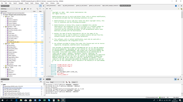

  • The reason I asked the question above about using the most current versions of SDKs is because when I follow each step of the "Building the demo" section, when I open the thingy52-mesh-provisioning-demo solution/project in SES and try to build, I get errors that files are missing.
    A few files are missing from the Application folder within SES.
    For example: ...\nrf_sdk_for_mesh\common\src\rtt_input.c: No such file or directory
    The rtt_input.c file above is actually in ...\nrf_sdk_for_mesh\examples\common\src
    My SDK_ROOT Global Macros are defined correctly.
