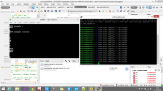

I am trying to send some data from RPi , And I am using the example of NRf Uart APP.

This is the section i am having difficulty understanding
I am sharing the output screen also.
As you can see what i expect as an outout and what i get.
Please help.
Right window is an Rpi window via putty and the left window is a tera term debug terminal
I have tried changing clock speeds,that doesn't help.
I have verified TX and RX pins and jumber wires are fine.I am not using CTS and RTS pins
I have connected RPi to a USB TTL converter and i was able to receive the data.
