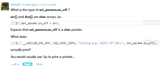

i am using two boards , example A and B .. A will sent a message to B And that message has to be read and write on uart using termite

see the code below this how i set the character in client side
char arr[5] = "code";
char ara[5] = "set";
switch(button_number)
case 0:
case 2:
set_params.on_off = arr;
case 1:
case 3:
set_params.on_off = Ara;
set_params.tid = tid++;
transition_params.delay_ms = APP_CONFIG_ONOFF_DELAY_MS;
transition_params.transition_time_ms = APP_CONFIG_ONOFF_TRANSITION_TIME_MS;
__LOG(LOG_SRC_APP, LOG_LEVEL_INFO, "Sending msg: ONOFF SET %d\n", set_params.on_off);
check whether it is correct or wrong
What is the type of set_params.on_off ?
arr[] and Ara[] are char arrays, so:
Expects that set_params.on_off is a char pointer.
What does
actually print?
You would usually use %p to print a pointer...

ps_anu Have you looked at the tips awneil has given. Are you receiving any logging information on the receiving node? You need to make sure that the boolean value is changed everywhere in the code necessary to the correct data type (char pointer as mentioned by @awneil). I have mentioned this in previous comments.
yeah i am receiving logging information but i am not getting the char which i have sent
So, again, have you checked your data types?
how would you say that set_params.on_off is pointer?
I didn't say that it was - I said that the way you are using it requires that it is!
Aha - I found what I actually said:
As I said, arr[] and Ara[] are char arrays, so this assignment:
expects that set_params.on_off is a char pointer.
If set_params.on_off is not, in fact, a char pointer - then that code is not going to do what you want!
Again, this is standard 'C' programming - nothing specifically to do with Nordic:
The thing on the left-hand side of an assignment has to be of the same type (or a "compatible" type) as the thing on the right-hand side of the assignment.
