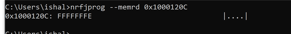

1. CONFIG_NFCT_PINS_AS_GPIO in processor definitions (I'm using Em Studio)

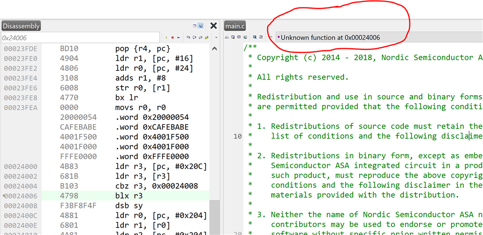

2. Added the "const uint32_t UICR_ADDR_0x20C    __attribute__((at(0x1000120C))) __attribute__((used)) = 0xFFFFFFFE" line in the uicr_config.h file and added the file to the folder my main.c is.
3. Went to the project makefile and added line "CFLAGS += -DCONFIG_NFCT_PINS_AS_GPIOS"
But nothing worked.
