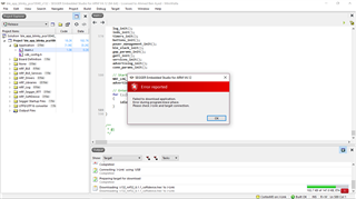

Please can someone help me to undrestand this error while running other exemples in my nrf 51 DK with nrf 51422
PS: IDE : Segger Embedded Studio
SDK : NRF5_SDK_15.xxx
Thanks.
Thanks.
SDK 15 is not supported by nRF51. The latest SDK that supports nRF51 is SDK 12.x.x
Best regards
Jared
Yeah that is the latest SDK supported by the NRF51 series Ammar_AH. You should check the compatibility matrix for more information.
