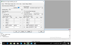

  • I changed the size from 4000 to E000, now I am getting following error
    .\_build\nrf52832_xxaa_s132.axf: Error: L6218E: Undefined symbol Image$$RW_IRAM1$$Base (referred from softdevice_handler.o).
    Not enough information to produce a FEEDBACK file.
    Not enough information to list load addresses in the image map.

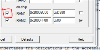

  • Could you upload a screenshot that shows the IROM/RAM settings in Keil ?
    It looks like you have removed the check in the IRAM1 checkbox. It should look like this:
  • Hi Sigurd,
    Now it is working fine, thanks for the help.
