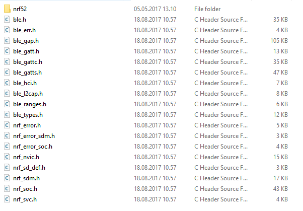

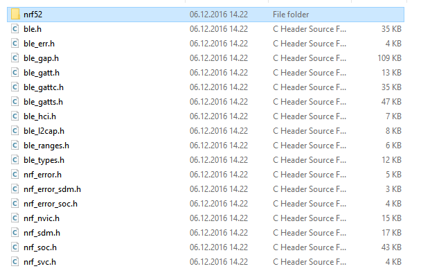

  • Looks quite similar to me comparing the S132 v3.0.0 SD:
    with the S132 v3.1.0 SD:
