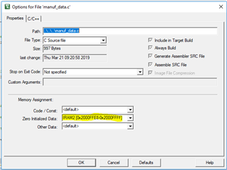

    I have made an example based on the ble_app_uart project in sdk 15.3.0 with a "noinit" section placed at the end of RAM. The project is attached below along with some screenshots showing relevant project settings. Hope this helps.
    Adding IRAM2 for NoInit data:
    I have not found a way to selectively chose which variables to place in NoInit without touching the Scatter file so  l defined the m_addl_adv_manuf_data variable in a separate source file:
    And the *.map file confirms that m_addl_adv_manuf_data got placed in IRAM2

    Also, I have evaluation version of keil, so I think scatter file will not work. How do I do the similar thing of creating IRAM2 in IAR?

    That's correct. You can't edit the scatter file in the lite version. This is why I didn't use the scatter file in the example I sent you.
