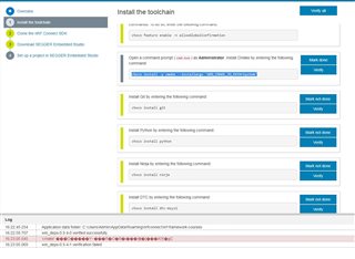

I can't load the project to SEGGER Embedded Studio.
I  can't  install CMake by entering the those command (choco install -y cmake --installargs 'ADD_CMAKE_TO_PATH=System')
So I download CMake from their website
After  install  CMake , nRF connect SDK verify still not pass!
By the way,I can't find correct GNU Arm Embedded Toolchain version for my system os (windows 7 64-bit)
    In order for SES (Nordic Edition) to find cmake, it needs to be in your PATH.
    You can check if cmake is in your path by opening a cmd.exe prompt and write "cmake". If it does not find it, you need to edit your environmental variables and add cmake to the path (you may have to reboot in order to apply the settings).
    Could you try this and see if SES starts working?

  • Hi ,
    I success to install CMake,
    But project load still failed, and I got following error message.
    Did you have any suggested?
    Loading solution asset_tracker.emProject
    Executing load commands
    cmake -GNinja -DBOARD=nrf9160_pca10090 -DBOARD_DIR=C:/nes/zephyr/boards/arm/nrf9160_pca10090 -DZEPHYR_TOOLCHAIN_VARIANT=gnuarmemb -DGNUARMEMB_TOOLCHAIN_PATH=C:/gnuarmemb -BC:/nes/nrf/samples/nrf9160/asset_tracker/build -HC:/nes/nrf/samples/nrf9160/asset_tracker
    Failed to create ConsoleBuf!
    setActiveInputCodepage failed!

    I have not seen these types of errors before. Could you ensure that you start with a clean build directory when trying to import the project?
    If you have had issues prior (with the configuration) and you re-configure in the same build folder, it may give you issues, so removing the build folder manually between each import is highly recommended.
    Håkon
  • Hi
    After I re-pull all file from git
    I can build project on SES.
    Thanks for your help!
