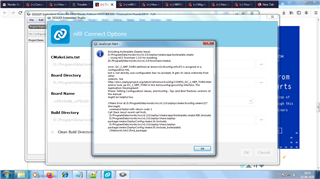

  • Hi
    I tried the code the works for you. but i am getting below error
