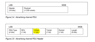

The advert decoded by this phones has the first 6 letters (generally) correct, and after, the decoded value varies. We use nRF Connect for testing, and while scanning is active, you can see the advert name constantly changing.
All of this is using S132 6.1.1 on SDK 15.3
The issue started when we upgraded from SDK 11 and S130 2.0.1 or S132 3.0.0 to SDK 15 and S132 6.0.0
Attached, the system information of  2 of the phones having issues. The 3rd one we don't have much info, besides it was an iPhone bought in Taiwan.
Our hypothesis is there's a communication issue between the phones and the nRF52 (nRF52832_XXAA). We suspect from one soft device to another, something like timing may have changed a little, and these phone possibly don't comply with specs.
