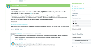

Single Byte SPI transfer with SDK15.2
I'm trying to implement the workaround for PAN58 on an nRF52832 device using SDK15.2
I've copied in the code from a previous post but I keep getting an error when I declare 'NRF_SPIM_Type * p_spim = TCspi.p_registers;' in the set up. The error I get says 'nrf_drv_spi_t {aka const struct <anonymous>}' has no member named 'p_registers'.
Init code is included. What am I doing wrong?
