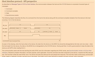

  • The spi functions are being called by main.c and are not interrupt based.
    But they commands/data they send over spi to a CC3100 SoC generate an interrupt when the CC3100 needs a reply.
    The functions are actually in another set of files, one the .c and the other a supporting header file.
    Those functions are used in the main body of main.c.
