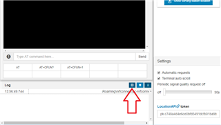

So I am trying to poll the signal strength of the nRF9160 DK and at first everything seems okay, the device gains connection and all the boxes in the LTE Link Monitor go green and can deliver RSRP values but after approximately 1 minute, it loses the ability to read the signal strength(RSRP -> 255). Then I have to reset the device again to read new signal strength values.
I am using a 1NCE sim card and am located in Germany and I have the NB-IoT firmware installed. I am using the AT+CESQ command to retrieve the signal strength information. The screenshots of the LTE link monitor output are below.
thanks in advance!

  • Could it be that a low-power mode is enabled, that is shutting down baseband if no outward connection are made or incoming?
  • Hi Dan,
    Are you running the standard AT_Client or a customized version? Please load the standard AT_Client and let it run for some minutes in LTE Link Monitor. Then, from the LTE Link Monitor, click Open Log File in the bottom part of the window (see image below):
    Please provide a screenshot of the LTE Link Monitor as well. Can you please contact 1NCE and ask what band they support in NB-IoT? From the screenshot you have provided, the command %XCBAND shows the supported band for the modem.
    Thank you!
    Øyvind

  • Hi Øyvind,
    I am running the standard AT_Client and can confirm(as KnutS says) that 1NCE is provided by Deutsche Telekom on Band 8 in Germany.
    kind regards,
    Dan

  • Thank you, Dan.
    Can you also provide a modem trace from your board? Follow these instructions:
    1. Program the hex file zephyr_at_client.hex with this command
      nrfjprog.exe --program zephyr_at_client.hex -f nrf91 --sectorerase --verify  zephyr_at_client.hex
    2. Reset the board.
    3. Install "Trace Collector" in nRF Connect 2.6.2, then open and connect to the nRF91 board.
      1. Click "Start capture"
    4. Open LTE Link Monitor and connect to nRF91.
      1. Reset the board once more.
      2. Enter the AT command AT%XMODEMTRACE=1,2 and click send. Should return OK.
    5. Start AT_client application with AT+CFUN?
    6. In the Trace Collector keep your eyes on the trace size, if the size is increasing then it is working.
    7. When AT_client has reached its end, you can stop the Trace Collector and click "Show in folder".
      1. Then attach the trace file here, so that I can forward to our internal team.
    I will forward both trace file and log file to our internal team.
    Thank you!
    Øyvind
